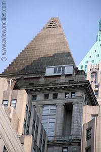

For a long time, steel construction consisted of what is essentially many boxes stacked on top of each other. With this type of design, the load is evenly distributed across all of the columns, and there is no technical need for a central core beyond practicality and space planning. For example, 14 Wall Street features an elevator bank and utility "core" that is actually located at the perimeter of the tower, and if you look at photos, the western face has blocked out windows.
Note the opaque windows on the tower, denoting where the elevator shaft is aligned.
